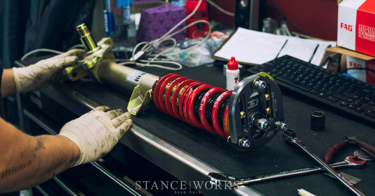

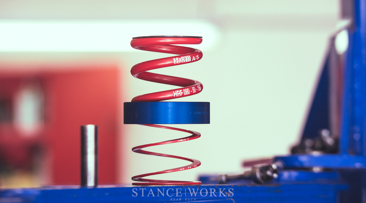

Using supplied cores, the H&R team tests OEM factory spindles for trueness before machining and pairing them with their monotube gas-shock coilovers. The entire system is, of course, built in Germany, and each kit is engineered specifically for each chassis. Variables such as vehicle weight, suspension travel length, damping, rebound, and more, are all taken into consideration, and derived by using actual cars for analysis. Unlike the parts-bin approach, H&R’s systems have been tested, refined, and improved to prove the renowned quality the brand is known for.
Aside from being one of the only bolt-on solution for your E30, E28, E9, or any other classic Bimmer, we’re bound to say it’s likely the best option as well. As such, it was our go-to when updating the suspension on Byron Wilcox’s ’84 318i, and we paired them with a fresh set of H&R sway bars.
As a bolt-on affair, installation was as simple as it gets. In the rear, it was as easy as dropping the rear shock: two bolts up top and one on the bottom. The new spring was swapped in, and the new shock was slipped into place, and then reassembled. The front wasn’t much more work; after removing the 3 nuts for the strut hat, the two bolts for the brake caliper, and the two bolts for the spindle base, the front was ready to swap in as well. During assembly, fresh wheel hubs were installed for good measure.
