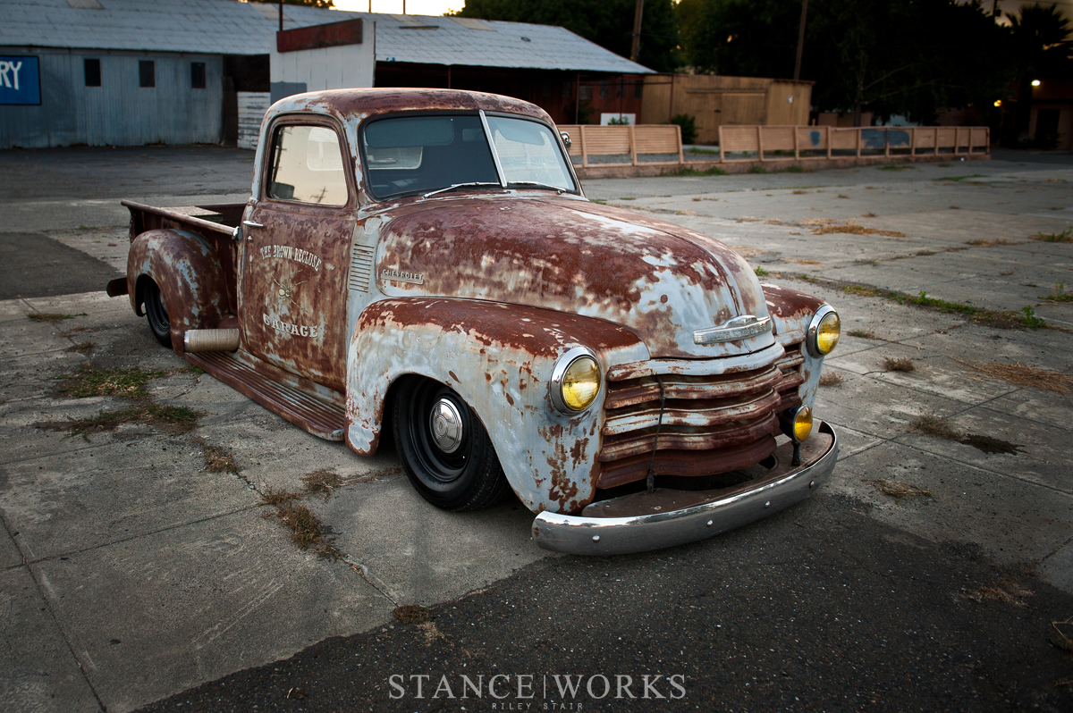

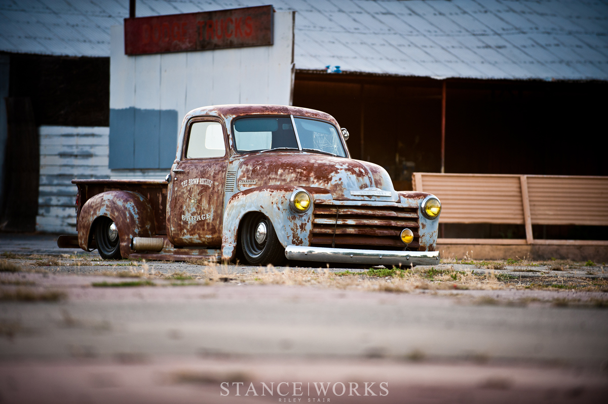

The weekend finally arrived, and the engine was purchased and brought back home. Energized with the new purchase, and new direction for the old pickup, we quickly sourced a Getrag 360 5spd manual transmission to transfer the 5.9 liter Cummins power to the rear end: a Chevy car 10 bolt geared to a 2.90:1 ratio to avoid over-revving the diesels 3,000 rpm redline. With all of the major parts for the transplant assembled in front of the truck, it came time to tear into the old pickup once again, this time for the most invasive undertaking of either of our automotive endeavors.
Having recently swapped an m60b40 v8 into my e28, we were fairly certain that we knew the “big engine into a little bay” game…we were sorely mistaken. While previous swaps were a tight fit, most of the stock sheet metal could be retained. This would not be the case for the once humble ’49. We removed the front clip along with the old powertrain of the transplant patient, and attempted to swing the massive 5.9-liter heart between the frame rails. The dimensions of the new engine were made real, as it stuck a full cylinder out of the front of the truck while resting on the firewall. Along with the length, the height of the straight six was staggering. With the chassis at ride height, but the oil pan firmly on the ground, the bell housing and gearbox sat well into the floor of the cabin… not ideal for a truck whose body would soon be grounded. Armed with a cutoff wheel, the firewall and floor were removed, allowing the new powertrain to be lifted well above the cross member, and pushed back enough to fit the front clip around it.
Engine mounts were fabricated, along with a transmission cross member and mount. With the transmission raised so far into the cab, a tunnel was fabricated to house the custom driveline. With the motor pushed back, the firewall would need to be made around cylinder 5 and 6. Not equipped with the tooling to create an aesthetically pleasing engine tunnel in the firewall, and my Father working in the trades his whole life, a wheelbarrow seemed fitting. Cut and sectioned, the wheelbarrow serves as a center section of the firewall, rounding the rear of the engine and separating the cabin from engine compartment. Eighteen gauge sheet metal makes up the rest of the firewall and floor, spot welded and seam sealed to ensure that it doesn’t rattle loose as the exhaust runs underneath it by way of a five inch straight pipe, exiting the truck just before the rear fender above the passenger side running board.
With the engine and transmission resting in the chassis, and the cab complete once again, air suspension parts were sourced, compliments of local shop BC Fabrication. Leaving no time wasted, we quickly removed the old tired suspension and pulled the bed from the rear of the truck. A Carpenter by trade and living by the mantra “measure twice, cut once” my Father and I tediously measured heights and clearances, finding that the rear of the frame would need to be cut off and notched eight inches. With the rear end now going to travel so far up into the frame, combined with the transmission set well above the frame rails, the driveline would directly intersect the main cross member at the back of the cab. The remedy: an eight-inch tall drive shaft hoop made into the center of the member. A parallel four link holds the rear end straight, while allowing all of the suspension travel the air bags can provide.
With ’71 Chevelle independent front suspension and a matching cross member, when the bellow bags were installed, there was no longer provision for shock absorbers. Shock hoops were fabricated from the frame, allowing a shock to be mounted atop the upper “A” arm. To achieve our goal and set the running boards on the ground, we were forced to filet two inches off of the bottom of the front member, reinforce it, and plate it back up.

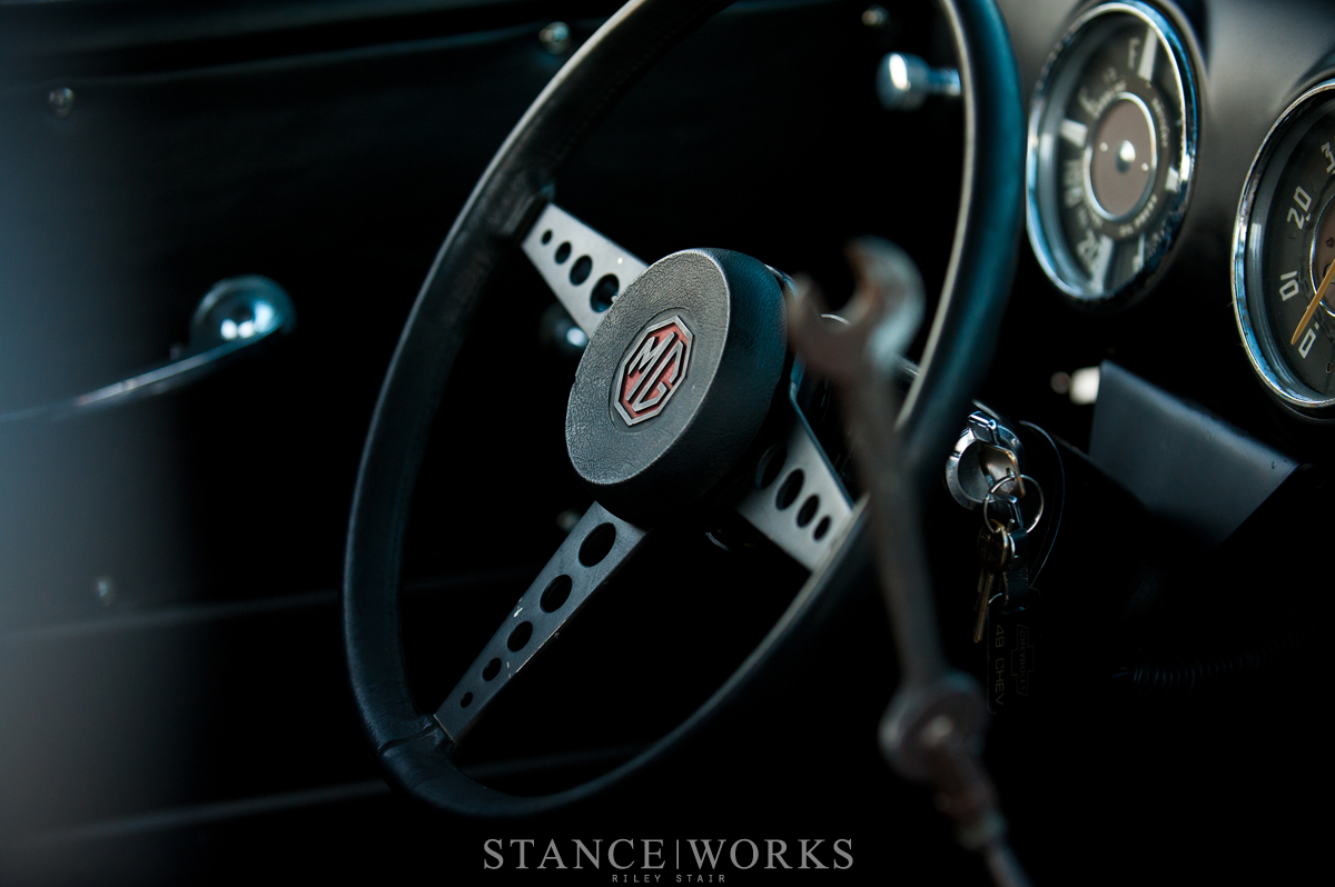

With the truck now at an acceptable elevation, we turned to the interior. Several layers of Dynamat and Satin black paint were applied to the original sheet metal and the old rear seat from my e28 was fitted, looking right at home amongst the modified black carpet kit and MG Midget steering wheel.  With all of the air lines run into the cabin, a box was made to house the manual paddle valves and gauges, making for easy height adjustments on the fly. The ¼” airlines are fed from an air tank hidden under the raised tongue and groove bed floor. The source of air resides in an old military box, a single viair 480 is left to pump 5 gallons of air into the tank, most of which is sent up to the front of the vehicle to lift the massive weight of the engine.

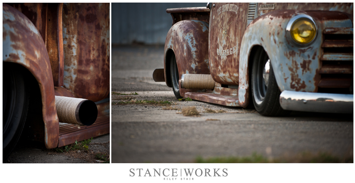

After turning up the fuel delivery on the stock lift pump, we plumbed fuel lines from the forklift fuel tank strapped to the bed floor. Fire hose was wrapped around the new fuel tank to ensure its place on the bed floor, and handcuffs were sentenced to a life of holding the tailgate shut.

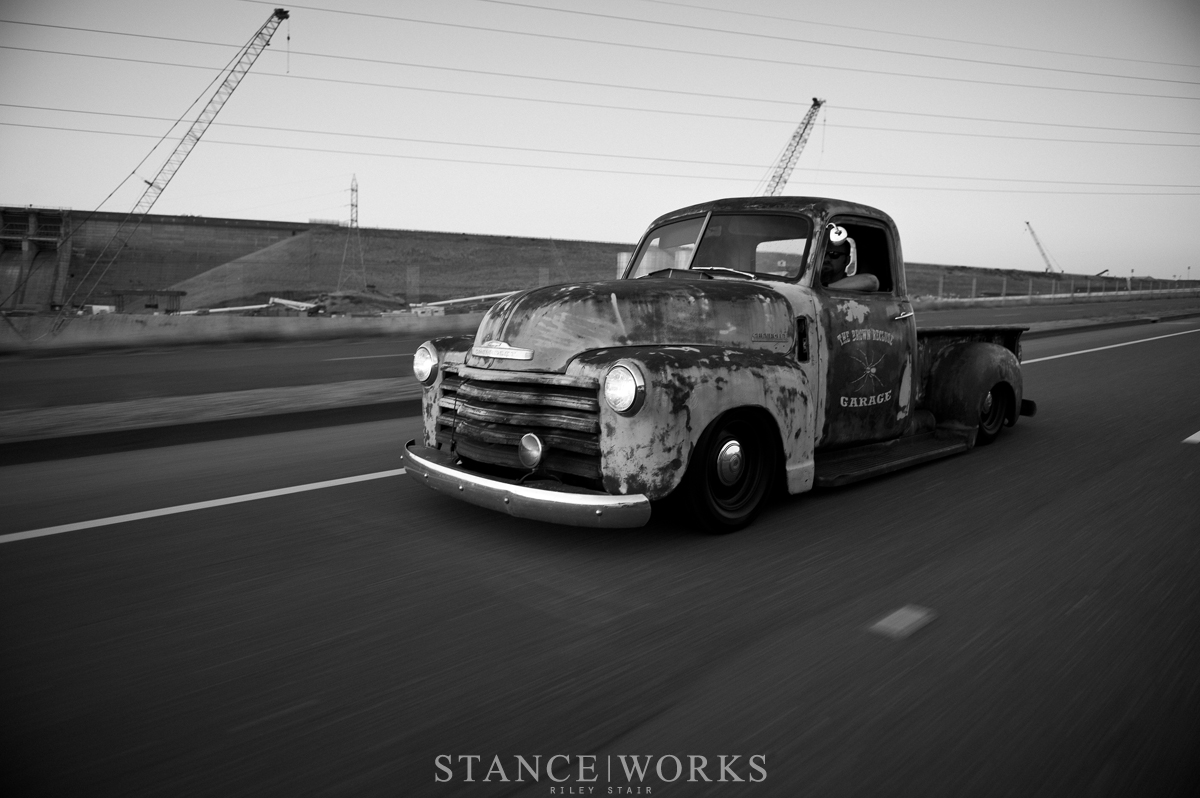

The time had finally come. After two months, enormous amounts of caffeine on many long nights, too many choice words, and an equal amount of burns and cuts all for this moment… The key was turned and our creation belched to life. The paddles were pushed sending air to the four corners, and the truck moaned and groaned in atrophy from its extensive operations. With the first drive complete, we were astounded at the sensory overload we had both experienced. The sound is that of a dump truck, while the ride is smooth like a stock car. Grinning ear to ear, my Dad and I realized why we do the things we do; because of moments like these. This was not just a truck, but a representation of why we love building cars; because they can be built however you want. They don’t have to conform to anything except your creativity and determination.
