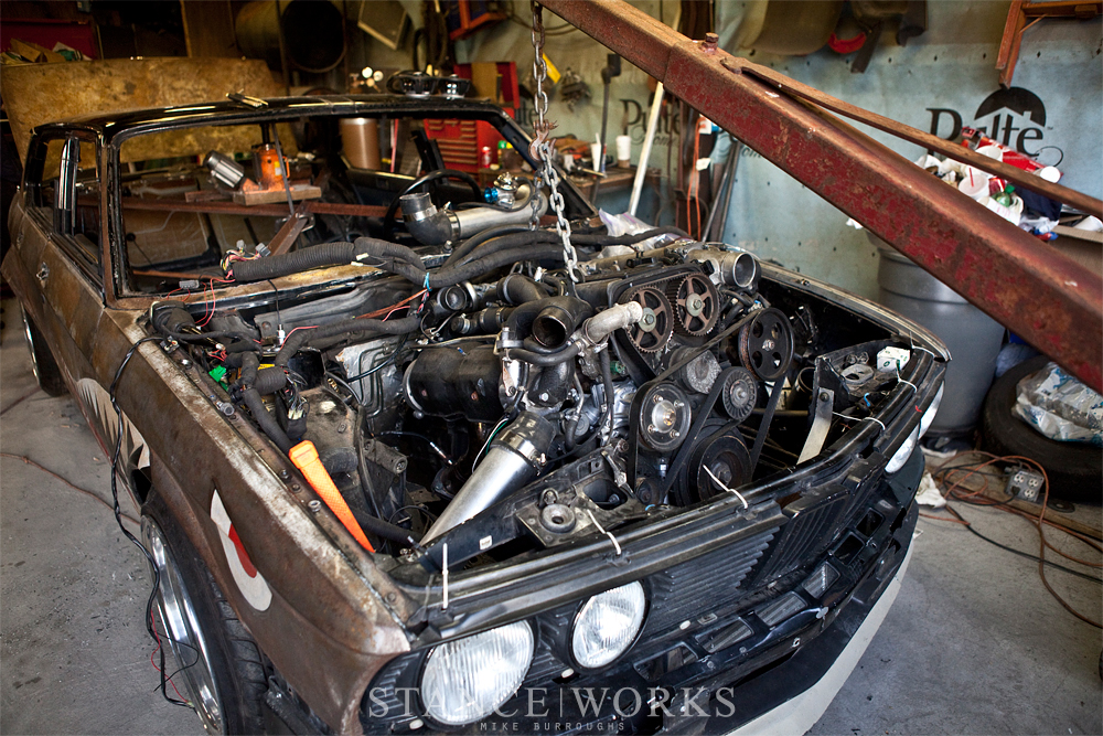

I had been hard at work on Rusty for months, wishfully prepping for an H2Oi unveiling. The plans are old news at this point – a body drop, air suspension, a chopped top, wild seats and an interior to match. Gold-plated Ronal splits were the icing on the cake, and everything had been running smoothly. Or at least, as smoothly as they could, all things considered.

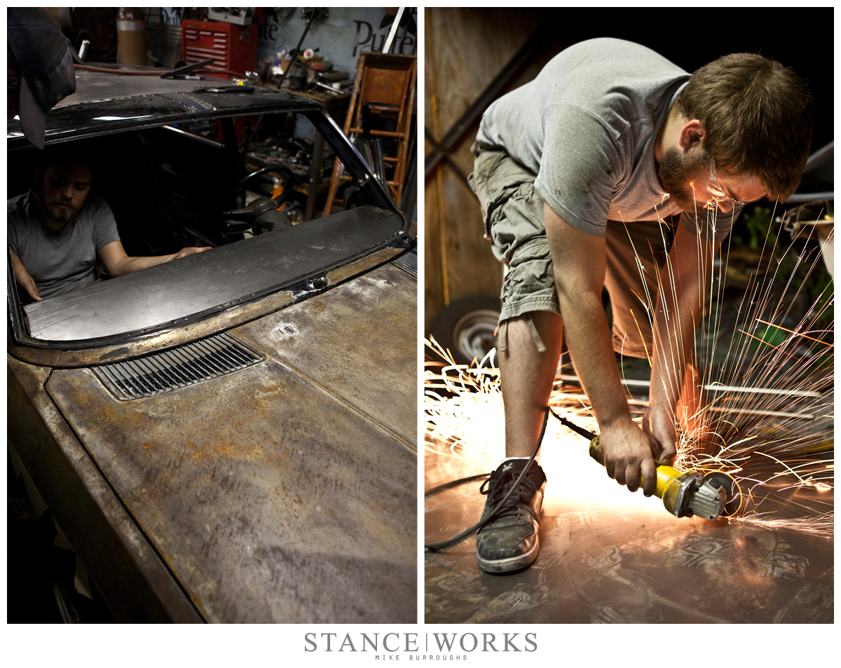

I had been bumming rides and borrowing a car from my roommate, Matt Moye. On nights that he didn’t have class or work, I’d steal his civic to make the trek out to the shop that belonged to my good friend and mentor, Chuck Yoder. It was in his shed that work went down late into the evening. Other times, Cory Hutchison would give me a ride and lend a helping hand. Rodney Nichols too – all familiar names to the StanceWorks homepage. For weeks, we’d worked together to get the car done; cutting, grinding, and welding away at the car in the spirit of reaching completion. As the days were marked off the calendar, the list never seemed to grow any shorter. As things were marked out with sharpie to signify their completion, a handful of additions were made. We knew we’d get done in time, but we’d be cutting it close, which is to be expected before the biggest show of the year.
Thursday morning rolled around – September 23rd. I was likely skipping class, knowing that if I wanted the car done in time, my studies would have to take a back seat. (Sorry mom.) The roof was on and the suspension was complete – my dream of the car laying flat on the ground had been realized after more notching and cutting than I had ever expected. Making room for the wheels and tires to fit within the fenders required hacking the car to bits, but it was worth it. The night before, I had dropped the engine into place; the fuel lines and driveshaft were all hooked up, and everything was ready to go.

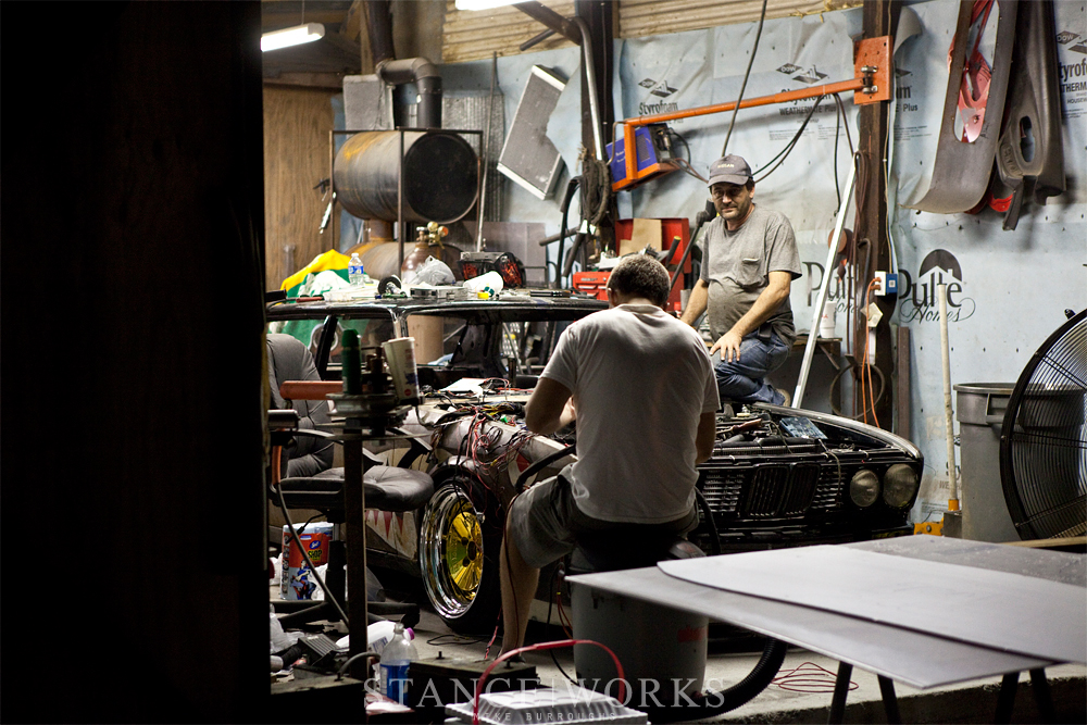

Chuck, Cory, and I stood under the fluorescents of the shop on that hot fall evening, swarmed with mosquitos and gnats, eager to finish the build. There were only a few steps left, but frankly, we were already late. A 14-hour drive lay ahead of us, meaning that, even if we left right then, we’d get there by Friday at noon, and we knew that wasn’t going to happen. A dash still needed to be made and installed, the seat brackets hadn’t been built, and the car hadn’t even been fired up. Hell, that was just the tip of the iceberg. Nonetheless, we trekked on, and as the list finally grew shorter, it became time to start ol’ Rusty up.

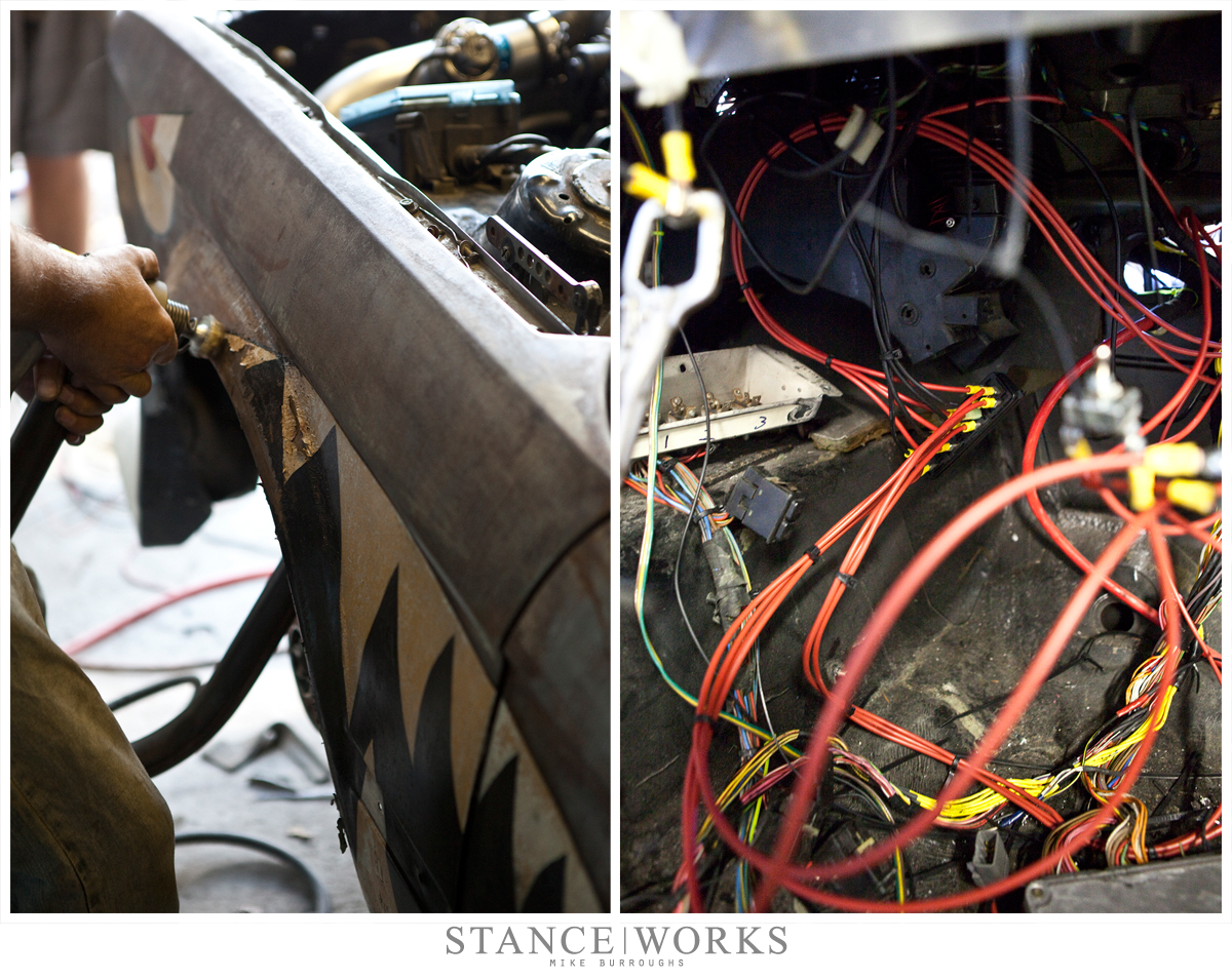

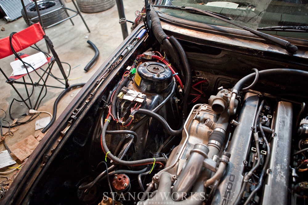

We began to cut the wiring harness apart, and the sensation of “what have I gotten myself into” set in rapidly. However, it wasn’t much more than an hour before we had managed to unhook the engine harness, and cut out everything that had burnt. If it had just been wires that needed replacing, maybe I could have done it, but the entire relay block and associated connections fused together, meaning I’d have to make that too.
I did the only thing I could think of – I called the friend who built the harness in the first place. His name was Jerry Buenviaje. At 2:00am on a school night, I blew up his phone. A groggy Californian answered, and I offered my bit. I told him I had messed up, and that I needed to fix it. Now. He gave me a run-through on how things worked – he explained the way a relay functions and how to hook one up. He told me what engine components I had to give power, and what work the ECU was going to do. He knew these engines better than anyone as far as I was concerned. The wiring diagrams he had used when he built my harness were ingrained into his mind. The best I could do was to scribble a list on the backing-paper of the insulation that lined the shop – alternator, ecu, map sensor, injectors, coils, and others – the things I had to hook up and give power. There was only so much Jerry could do from afar, but he pointed me in the right direction.

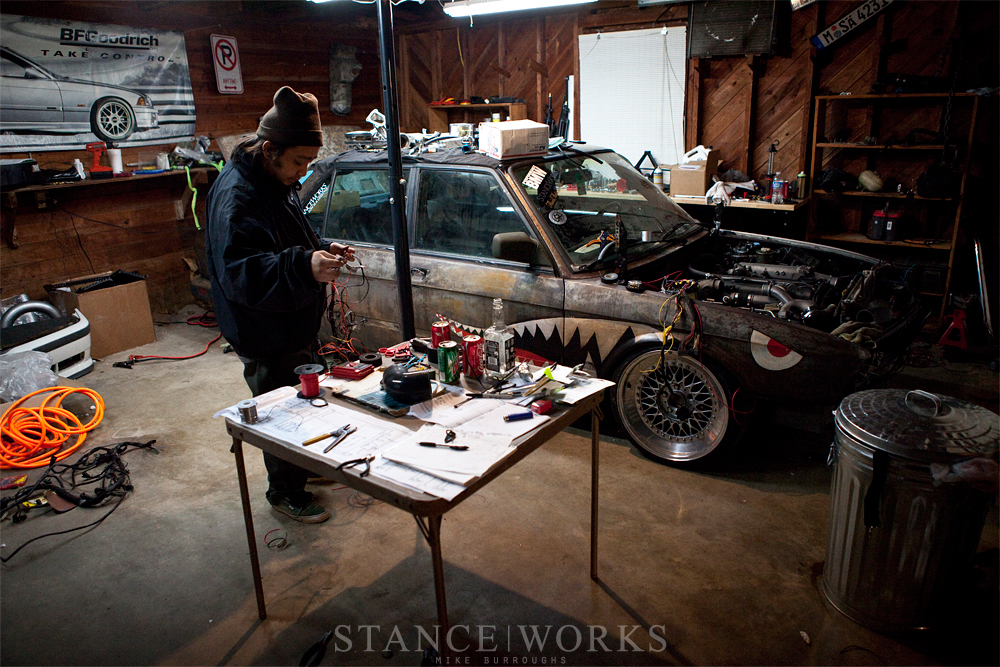

Cory and I made the trip to Wal-Mart, the only place still open that would have basic wiring supplies. I needed a handful of relays, several rolls of wire, electrical tape, every push-connector they had, and solder. We loaded up and headed back to the shop where I settled in for a long night. I sat inside the car where the passenger seat should have been with my legs crossed and the wire strippers and cutters in front of me.
I disassembled the engine harness, figuring out where Jerry had junctioned the injectors and coils. I figured out where the important plugs were – the ones Jerry had told me about. One by one, I began stringing red wire from my side of the firewall to the other, clamping on crimp-connectors as makeshift relay holders. I was struggling to keep everything straight, first working on all of the grounds, then the constant hot wires. The switched, and then the output. That’s the summarized version at least.
I sat there all night, crimping, cutting, and soldering, hoping that I was making progress. A relay for this, a relay for that, just as Jerry said. Cory had passed out hours ago on the back seat, legs dangling out of the car. “I stayed up as long as I physically could, trying to yank the copper strands from the mass of crispy plastic to at least try to trace them back to their origins, but somewhere around 3 or 4 AM, I finally crawled into the rear of the cabin and passed out on the lower cushion of Rusty’s back seat. It was the only remaining part of the factory interior, and the only part of the whole car a person could conceivably sleep on,” said Cory. Chuck has long since gone to bed; his wife and kids inside were more important than my scrap of steel. I was there through the night, working away, clinking and clanking as the crickets chirped and the frogs honked.
The sky began to glow slightly, starting with a deep blue and into purple, then pink and orange, and before long, the sun popped up over the tree line. Slowly but surely, things were coming together. It was beginning to look like a wiring harness. It looked like a blind amputee made it, and I’m sure any electrical engineer would have written it off as a total blunder, but to me, it was progress. I remember soldering the last two wires, and turning around to tap Cory on the knee. “Alright man, I think I’m gonna try to start it.”
