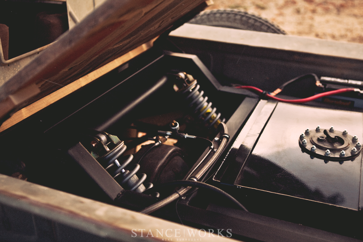

That’s when the drawing board came out. I realized I needed to be thinking 10 steps ahead of where I was at now, and even then, that might not be enough. Every decision I was about to make would impact every step that followed. I wanted to build the chassis from scratch, and that meant every dimension, angle, and void had to be accounted for. I’d have to know what size my future wheels would be, and the outside diameter of the tires I’d mount on them. I’d have to know how much I’d channel the body, and where the body would sit in relation to the wheels and suspension. Suddenly, I realized that there was much, much more to building a car from the ground up than meets the eye. But I’m the kind of person who says “if someone else can do it, then I can too.” So I went to the metal supply facility, loaded up on boxed steel 4×2 tubing, and went at it.
I’m sure somewhere I still have all of my sketches. I knew I wanted the car to sit ~2 inches off the ground, give or take (preferably take, because let’s be real, lower is always better). That meant that before I even had a single suspension component, I’d have to account for the static compression of the suspension, the final weight of the car, and the springrates that made it all work. I’d have to make sure that my 2″ ideal clearance was after the car had an engine in it and the springs compressed. I had to decide whether I’d sweep the frame, kink it, or Z it to accommodate for locating the front axle under the front of the truck. 10 steps ahead. Always think 10 steps ahead. I could go on and on about the measurements I had to establish, from the angle of my frame kink to the height of the frame from the ground with and without suspension droop. The list is endless, and frankly boring, as you either completely understand and have been in the same boat, or it’s simply inapplicable.  Fast forward through lots of notes, math, and experiments with springs, a jack, and safety glasses: I had a final sketch put together. It was time to buy a welder.

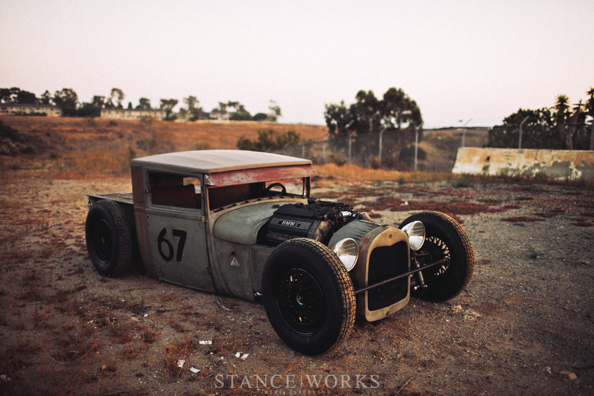

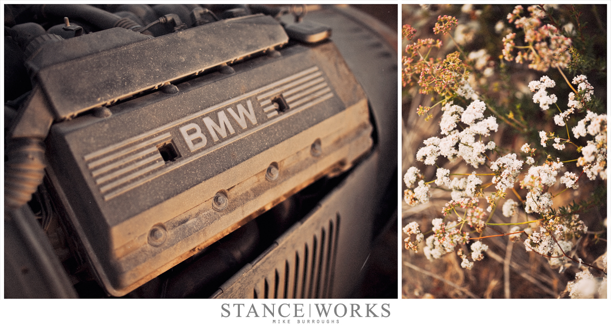

When I set out on this build, I knew I had to incorporate my love for BMW into the truck. Without it, it’d never really be my hot rod. Sure, it’d be cool, but it’d never be obvious that it’s Mike Burroughs’ truck, When I mixed the idea of Model A, BMW, and the need for the growl and burble of a V8, the answer was obvious: the BMW M60 had to be the powerplant. Sourced from a ’95 BMW 740, the 4.0L overhead-cam V8 pushes out right at around 300 horsepower and 300 lb-ft of torque – an absolute ton in a car that weighs 1500 pounds. The 740’s automatic transmission, on the other hand, wouldn’t do the trick, so I sourced a Getrag 420 6-speed from an E39 M5 to mate to the M60. The engine continues to run on the factory ECU, which, along with a custom fuse box and relay panel, is tucked away behind the firewall, out of sight and out of mind, yet within a waterproof housing to ensure it keeps tickin’ when the goin’ gets wet.
I’m well aware that the engine will be the point of contention for many hotrod purists, and likely BMW fans too. “It’s out of place.” “It sticks out like a sore thumb.” “It needs a Ford/Chevy/XXXXX motor.” It hasn’t even been a week and I’ve already heard it all. “I wish he had done something to make the engine look older, like aluminum valve covers.” But then I have to ask, would you know it was a BMW engine?  There are two dozen reasons why people will be quick to scoff at my choice of engine; some will say I’ve done it simply to be different, others will say that it doesn’t fit in any way. Yet I can’t help but smile as I’ve brought two things I love -two things that truly inspire me – together in my first ground-up build.

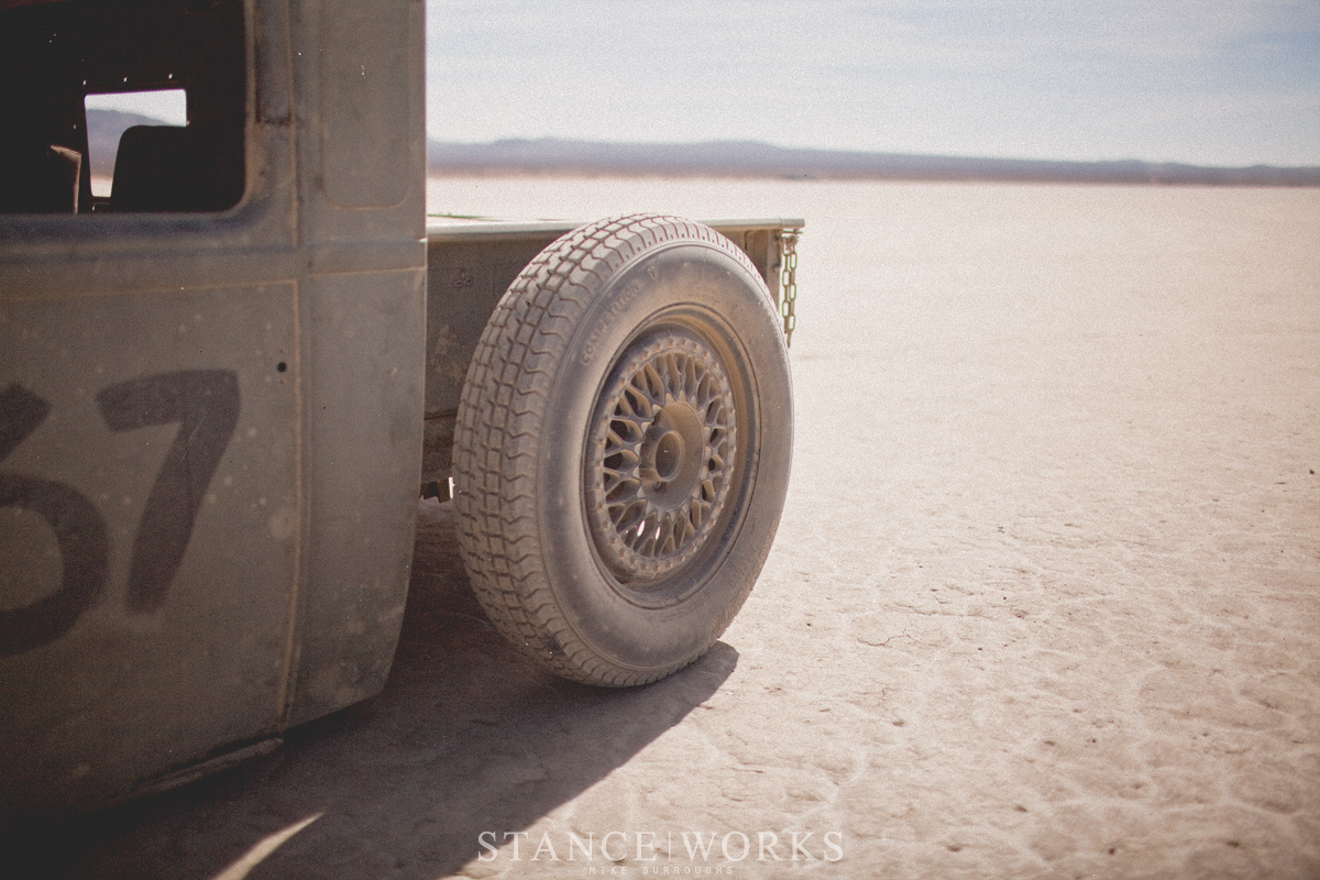

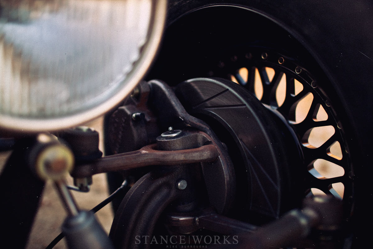

You can’t build a hot rod that won’t smoke both tires, so under the tail end of the truck is a Ford 8″ rear end, pulled from a 1966 Ford Mustang. The internals were tossed, and in their place, Byron and I installed a Yukon posi differential along with a 3.55 gear set to allow everything to fit properly. Between the rear end and the output shaft of the Getrag transmission sits a custom driveshaft, built by the team at Drivelines, Inc. A custom adapter was machined to allow the use of U-joints on each end of the driveshaft, as well as a slip yoke to account for the short 4-link that was required out back. With everything mated up, and solid-mounted to the frame, there’s no slack or give left – it’s all tire-spinning raw power straight to the wheels.

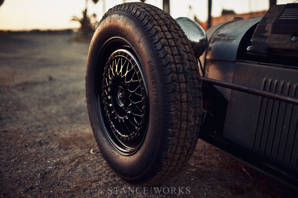

While BBS RSs may seem like an obvious choice of wheel, there’s far more to the decision than the simple blend between BMW and hot rodding. The motivation goes far, far deeper. The BBS RS has been the wheel of wheels for decades on end. It’s the pinnacle of wheel design to many, and it is the go-to for good reason. It is the king of modular wheels, but I wanted to take a wheel that has seemingly been everywhere to an entirely new realm. I’m not a fan of the wide-tires-out-back look on hot rods for the most part. The skinnies on all four corners and the traditional vibe is what does it for me. With that aesthetic in mind, and knowing that I wanted a very tall tire to embrace the style I was after, I sourced a set of RS centers (5×114.3 is my lug pattern of choice for those wondering) and got to work. Half-inch outers and custom-spun 3 inch inners thanks to the boys at Rotiform come together to create a set of BBSs just 4 inches in width. Sealing the wheels proved to be a challenge, yet my choice of Excelsior Competition V tires required tubes, so the seal wasn’t entirely crucial.
The wheels are aluminum and modular, meaning they’ll be quick to get shot down by many traditional rodders, but I think given the chance and explanation, their thoughts might change. It’s obvious that the BBS RS’s mesh design has been a source of inspiration for decades now, but the RS was not immaculately conceived. While the mesh style seems like one of the few basic designs from which all wheels are built, the mesh pattern draws its own inspiration from the wire wheels of years ago. The BBS RS is a wire wheel brought in to the 21st century, modernized to work with the lines of the ’80s, ’90s, and now. Built in a new way, and harking back to their roots in a way I’ve never seen, the BBS RS felt new once again. And they felt right at home on my rough and tumble hot rod.

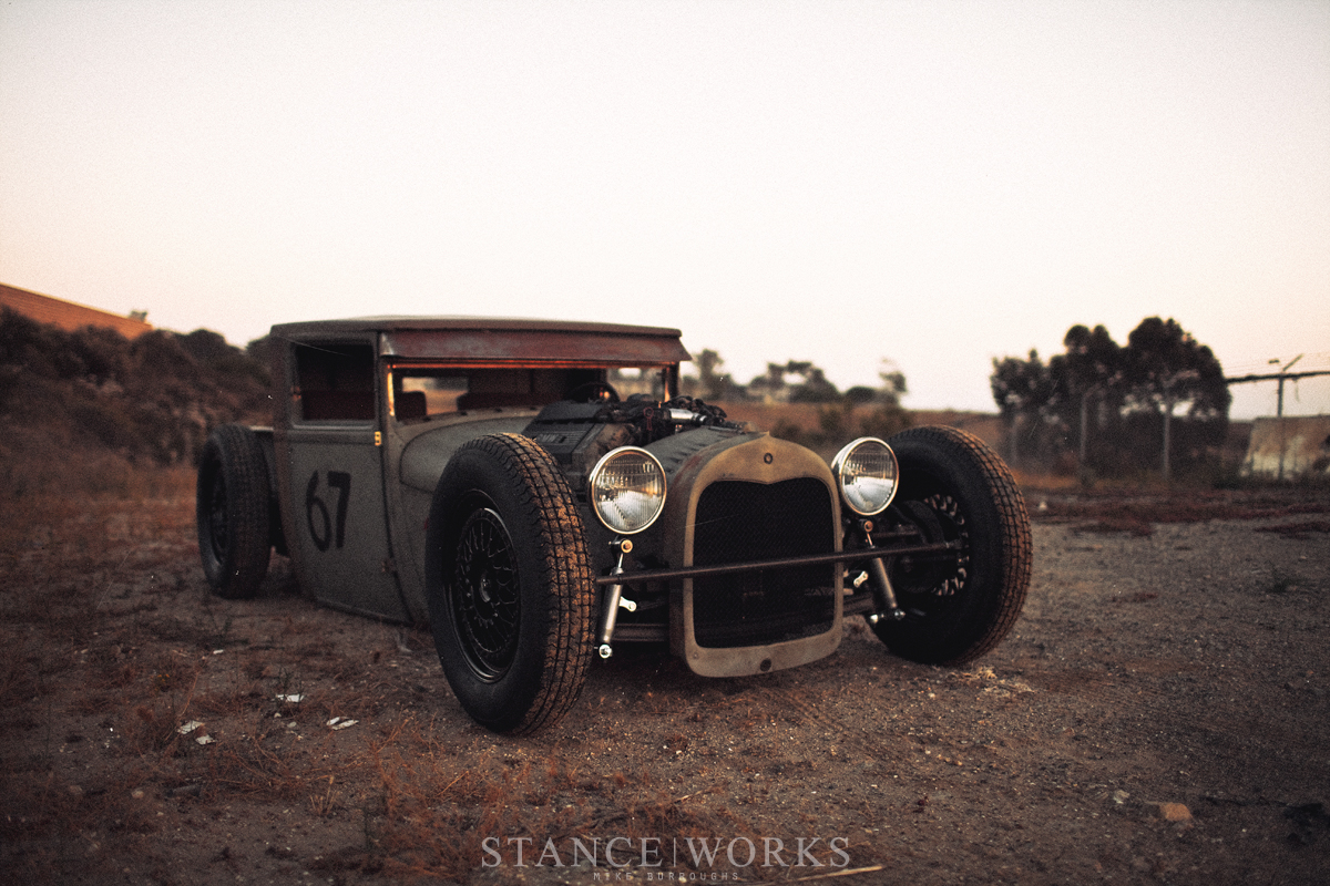

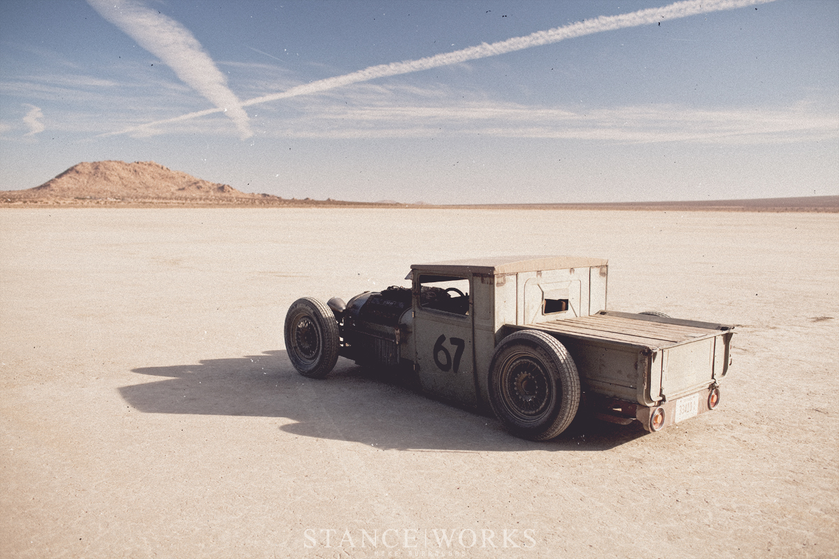

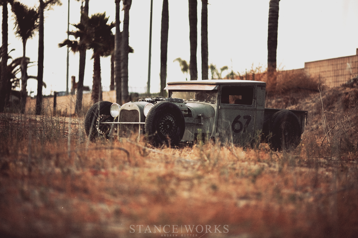

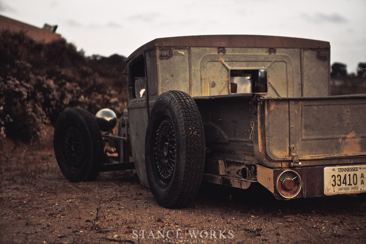

Despite the wheel and engine choice, I wanted the rest of the build to be relatively traditional (and I am sure I’ll get slain for using that word, but here goes!). I wanted the style of the truck to fit in line with something even the purists might approve of. While I’m missing some sheet metal to attach the roof in a factory-esque fashion, the rest of the body was assembled with a “survivor” mentality. I wanted to leave the patina just as I had found it, while slightly changing the lines to hit the style I envisioned. I wanted “slammed farm truck meets salt flat sprinter” and while it meets the mark in my eyes, I’ll let you decide.

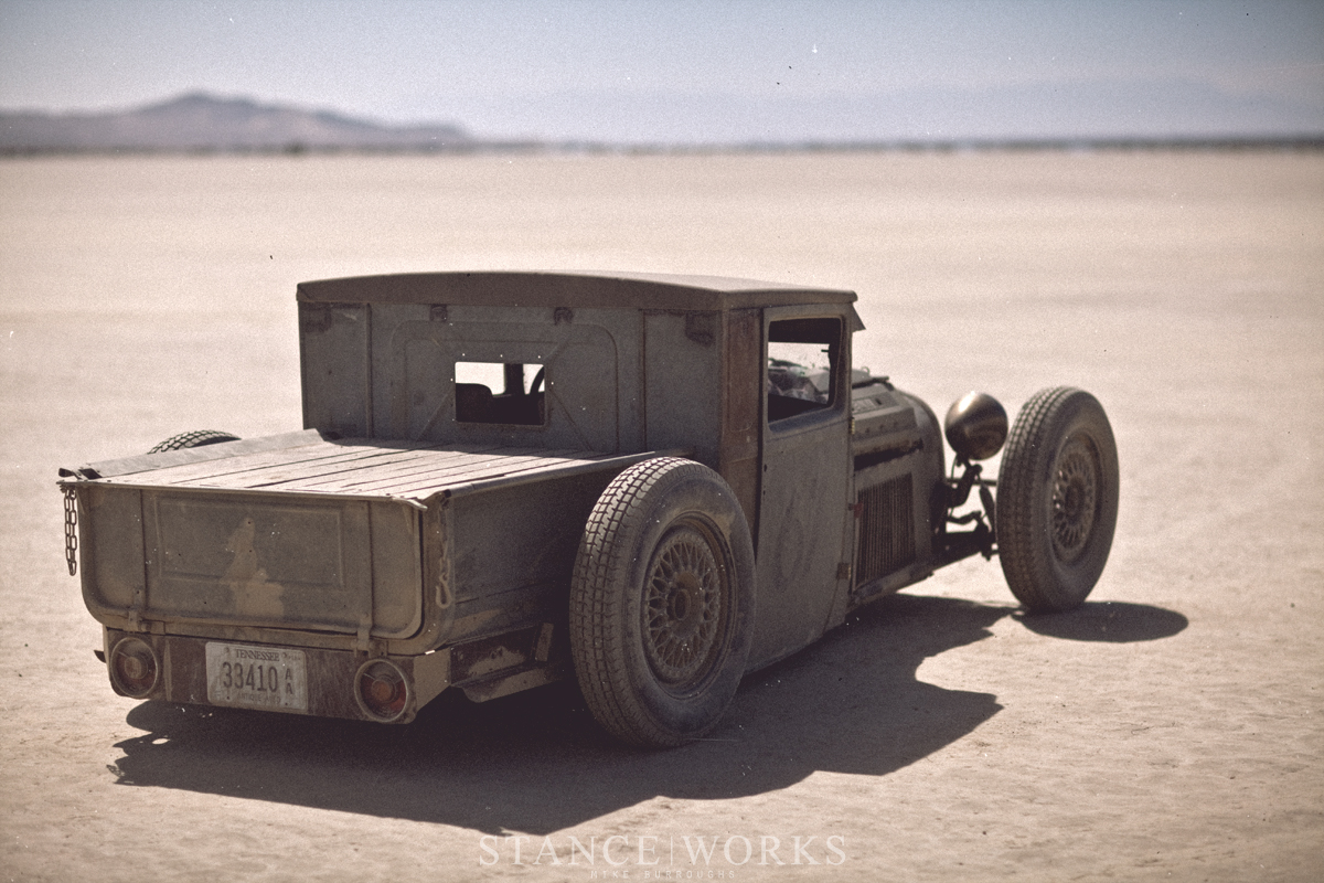

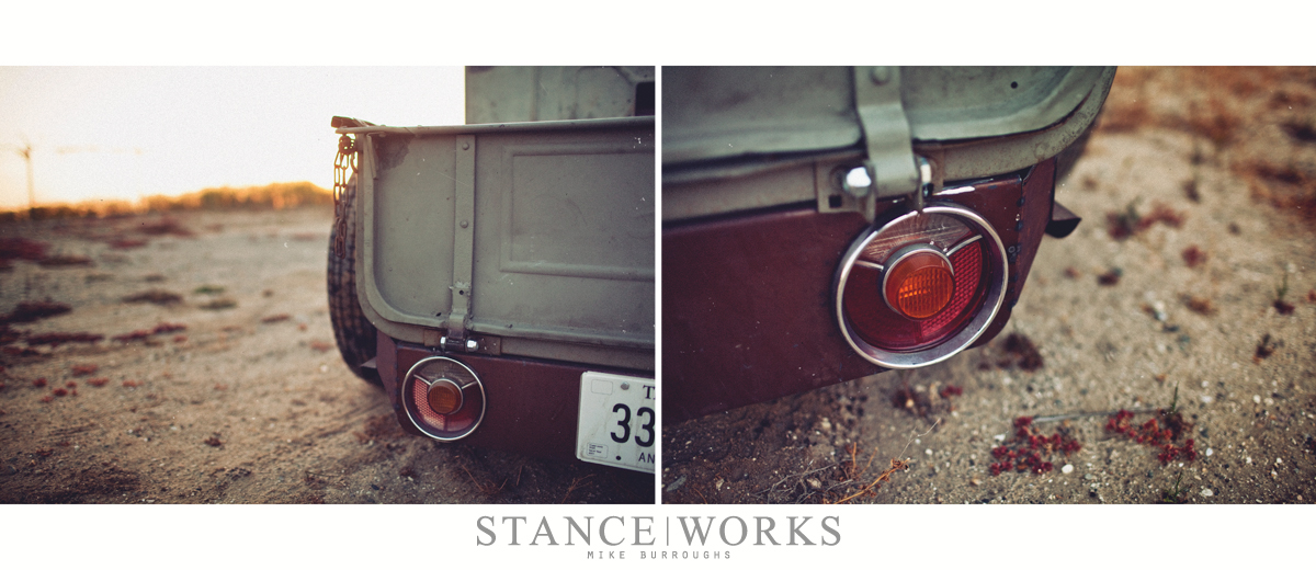

I moved the cab back about six inches in order to bring the rear wheel close to the cab’s back panel. It was a subtle hint of style that I felt increased the aggressive nature I was after. I raised the bed to align with the doors’ belt line, and re-attached the bed risers as pseudo bed sideskirts. The Fast and the Furious, 1928 style. For the front. I wanted the engine and hood paneling, but my choice of overhead cam engine made running a hood impossible. However, it was a blessing in disguise, giving me the chance to show off the M60 while still running the rest of the paneling to achieve the classic race look I felt it had.

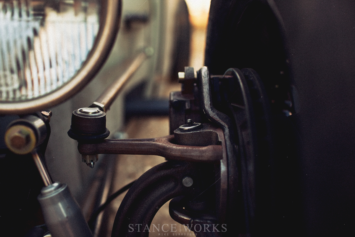

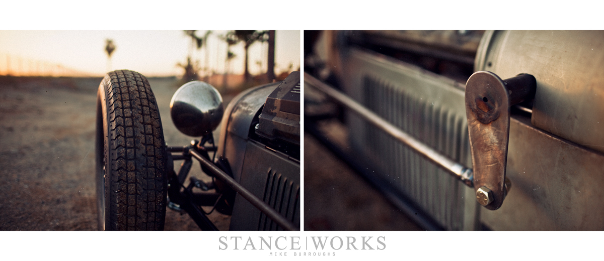

The easy way to achieve the slammed ride height would have been to run a suicide axle setup – where the front axle sits out in front of the nose of the truck, but it’s a style I’m not about. It butchers the face of the Model A and screams “rat rod” (which I insist this truck is not.) Instead, I opted to find a way to keep the axle under the front of the frame.  It was important to me to keep the wheelbase close to its original dimension, despite the lack of cabin room it was bound to leave – the stretched look, while great for leg room, fell in line with the suicide style. The decision brought an immense number of challenges, from fitting a radiator, fans, and coolant lines, to making the steering work without clipping the grille, while still maintaining a proper Ackerman angle.

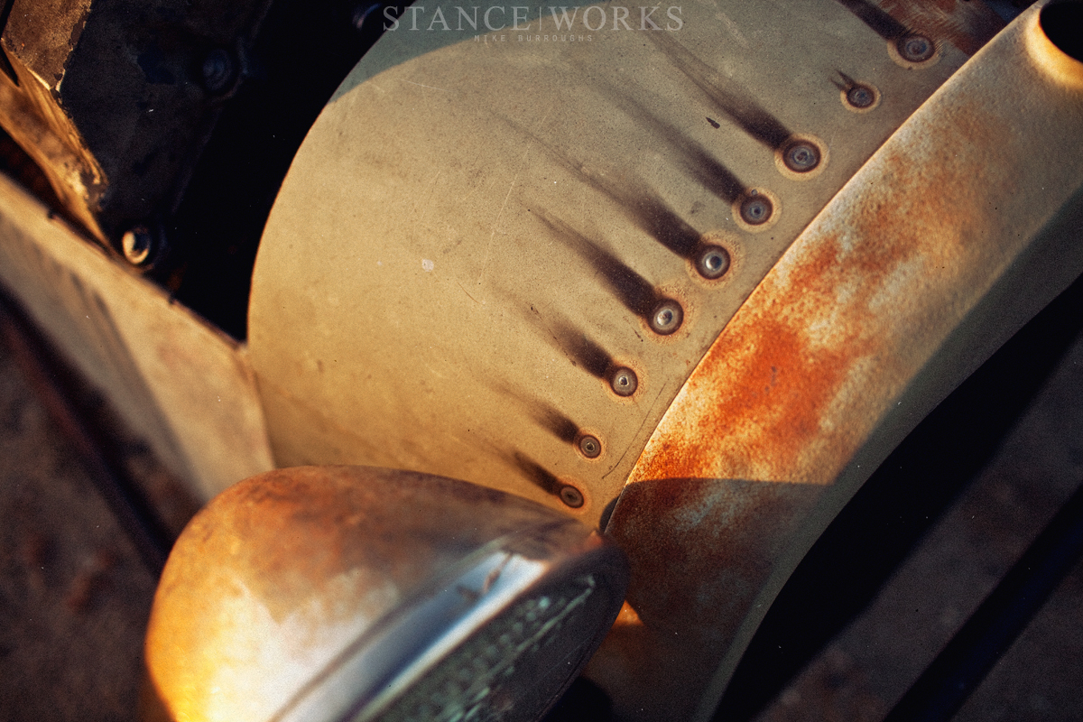

Some may identify the rough-and-tumble patina-wrought style as a “rat rod,” but as I said before, I’d stand by the opposite. The patina has been embraced, but underneath the rust and the rough edges is a frame, suspension system, and driveline that is new and thought out in every way. Everything shines with satin and gloss black, lurking underneath the aged outside where no one will be the wiser. I wanted a vehicle that was reliable, well built, and that, beneath the skin, hinted at a project that was thought out and carefully planned. A build that was completed from the heart. Everything from the 5″ drop axle and the springs, spindles, and brakes (thanks to Adam’s Rotors), to the triangulated 4-link, rear coilovers, and drums – it’s all brand new, providing a driving experience that finds itself on edge between absolute insanity and surprisingly impressive comfort.

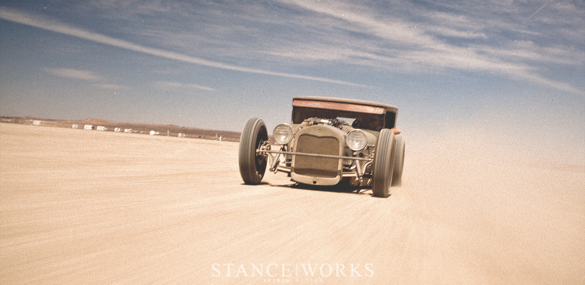

As said, it’s the drive that has been the payoff. While I can’t help but stop and stare every time I get out of the car, the urge to get back in takes the smile from obvious to “wow, my cheeks hurt.” The raw, loud scream of the BMW V8 is only made better by the paralleled bite it imparts. Without proper respect to the accelerator pedal, the rear end ignites the tires and scrambles down the street at a sideways angle. The speed of the truck is immense – faster than any car I’ve built before – and it puts a grin on my face every time I mash the throttle. But within mere seconds, I’m forced to let out as the archaic suspension struggles to keep the front end planted and the tires continue to spin through third at 70 miles per hour. It’s sheer power, and it is the reason hot rodding exists.
The ride is smooth and the track is straight – the frame of the truck has yet to smack the asphalt on the highway; however, it’s seen plenty of abuse as it struggles to get over the high point of every parking lot entrance. But as you’re all aware, the struggles are worth the effort. The vision-robbing front windshield is only a few inches tall, requiring patience and an arched back for any type of reasonable view of the road. The pedals sit far too close, thanks to a channeled floor and the massive transmission riding shotgun. The steering wheel is only 10 inches in diameter – any bigger and you’d find your arms colliding with your knees in every turn.  But the awkward seating position and lack of room is worth it, for who can argue the style?
