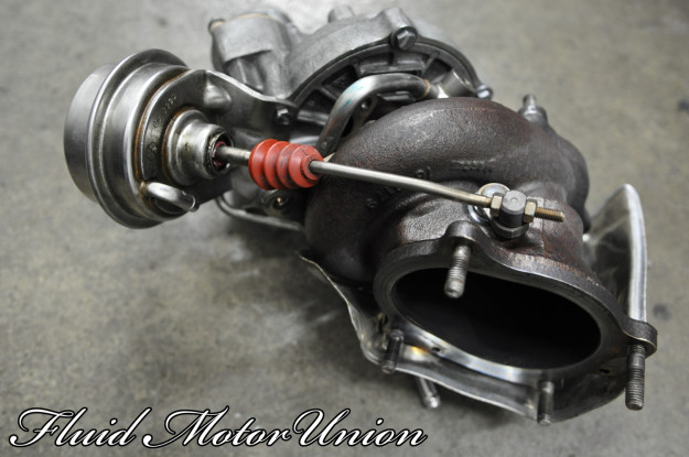

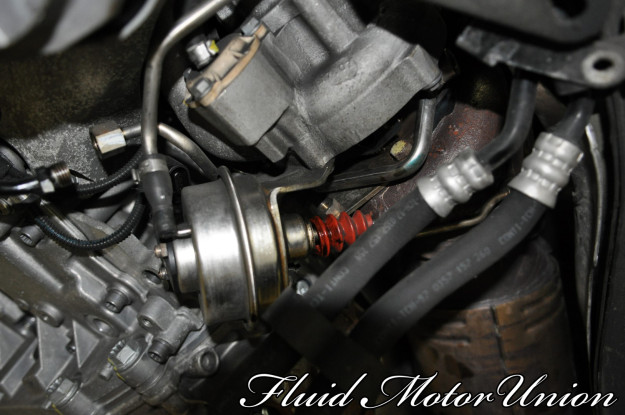

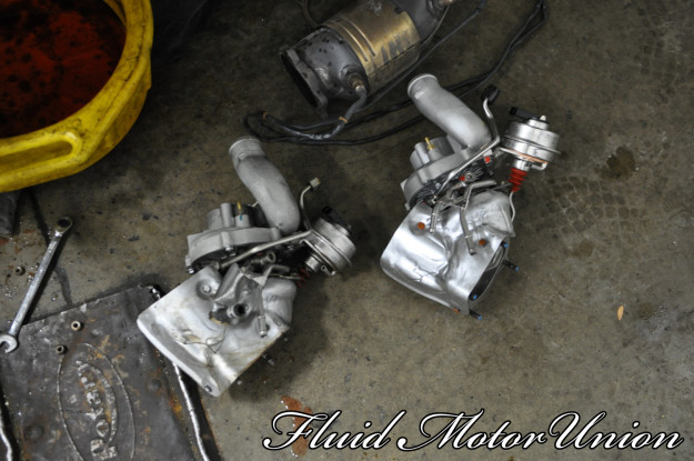

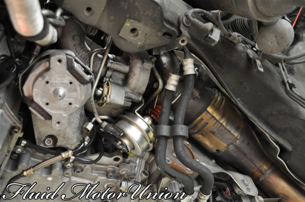

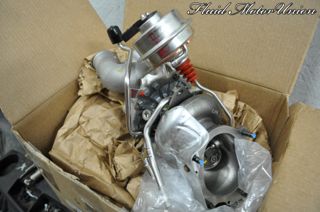

Using our experience and training, we quickly found the source of the issue using a system leak tester and smoke machine. The offender? A ruptured rubber wastegate diaphragm. To us, this was extremely disheartening, a 2008 Bentley with 59000 miles should not be having these kind of issues. Is it possible that the extra 4 psi of boost pressure from the new ECU tune was contributing to its early failure? I don’t see this as the root cause of the turbo problem, but it would certainly hasten its death. The likely culprit can be found in other blogs I have done on the use of recycled crankcase ventilation vapors. During our inspection it was evident that excess oil was present at the location of the leak. Oil vapors would gather into liquid oil in the rubber diaphragm, causing it to swell, and eventually fail.

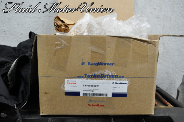

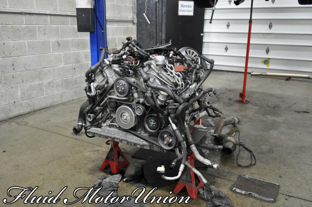

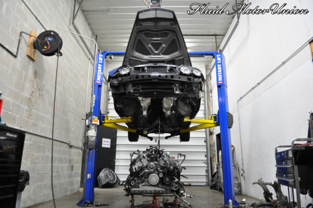

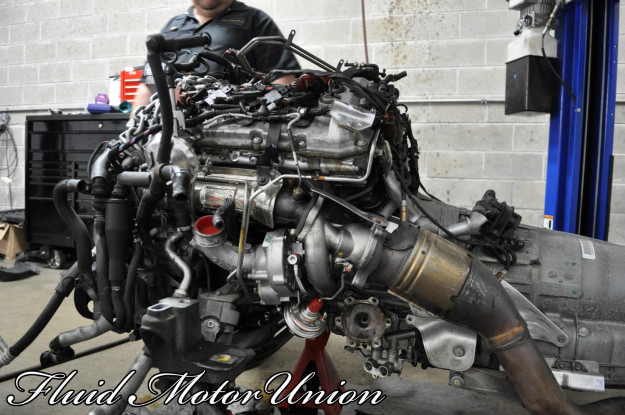

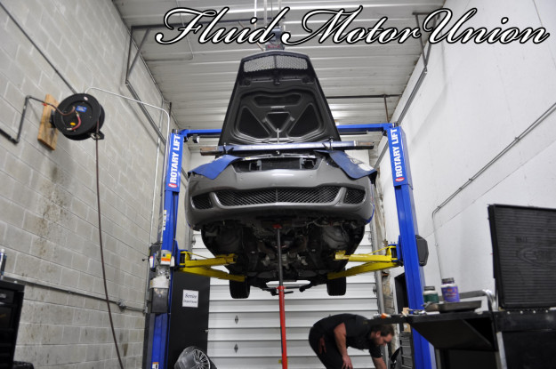

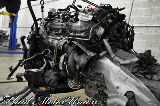

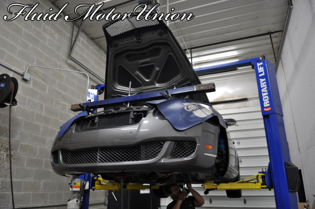

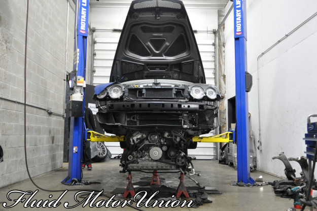

So just throw a new wastegate on and you’re all set, right? WRONG. While it is theoretically possible to swap just the wastegate onto the turbo, the absolutely precise settings needed by late model vehicles would make getting it the way it previously set an almost impossible task. Besides, Bentley only sells the entire turbo with wastegate, which means Grand Tourer heart surgery! That's right the entire engine has to come out in order to replace the turbo.

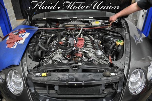

The pictures that follow show just what goes into replacing the turbo on this Continental GT Speed. As you can see, it’s quite a bit of work we wouldn't wish on any Bentley owner. Luckily, with a bit of hard work and a lot of skill, this Bentley was repaired and back on the road in no time. Hopefully, the next time we see it will be for some aesthetic modifications! Maybe a suspension lowering with a set of aftermarket wheels to really set it off.
