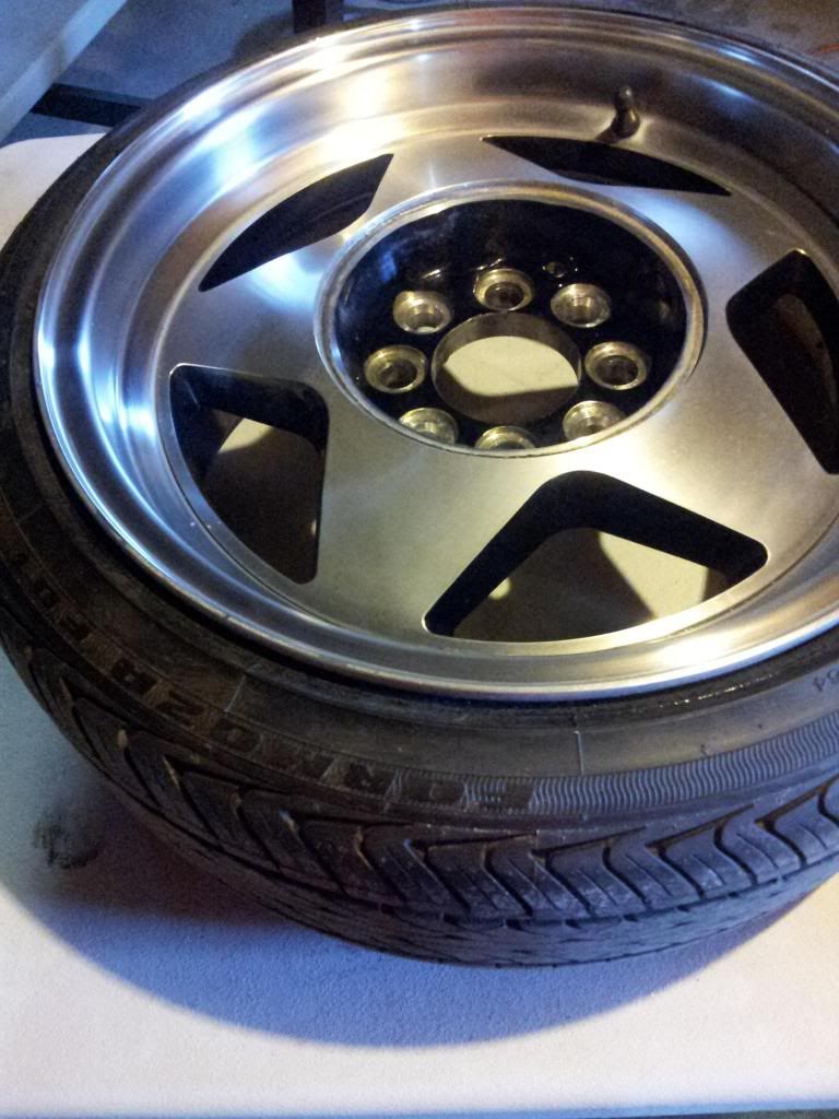

Spent a few hours polishing up the wheels I bought at a swapmeet
