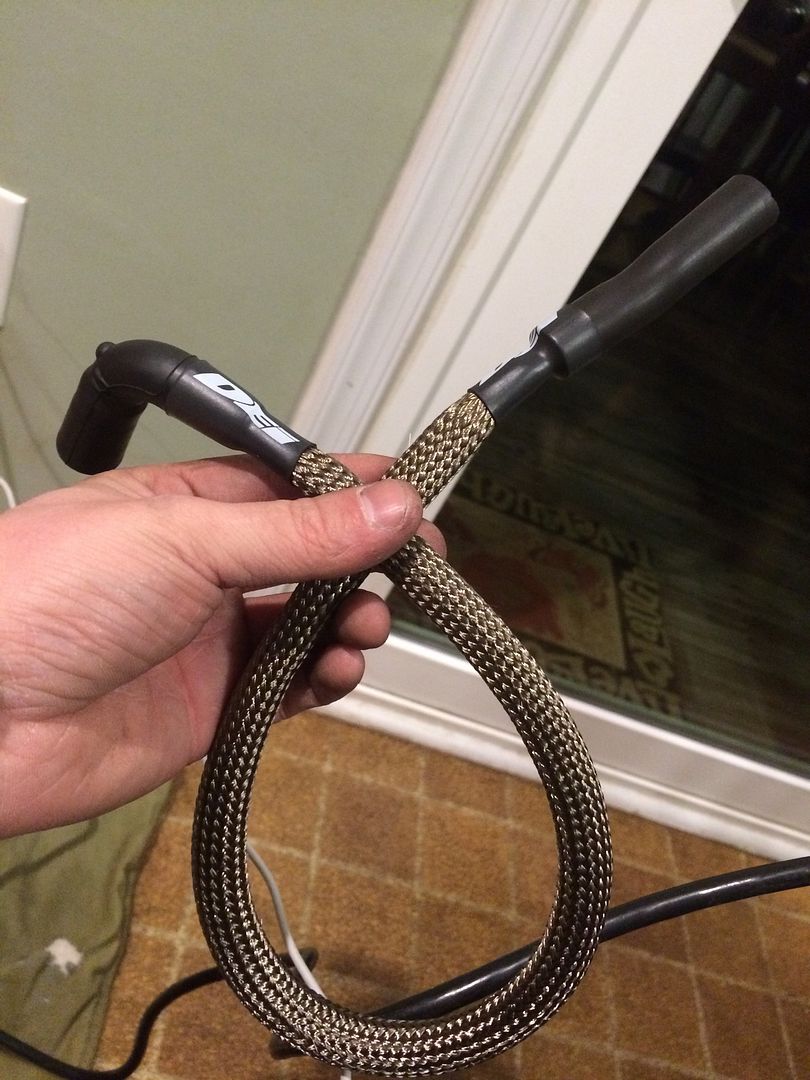

    Dei sleeves for the yellow plug wires

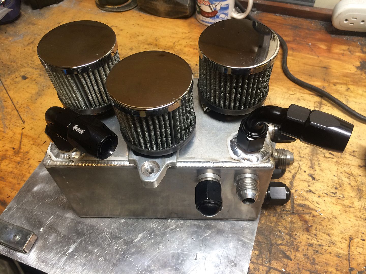

    Welded on some more bungs for extra breather hoses because I like to think I'm wealthy haha

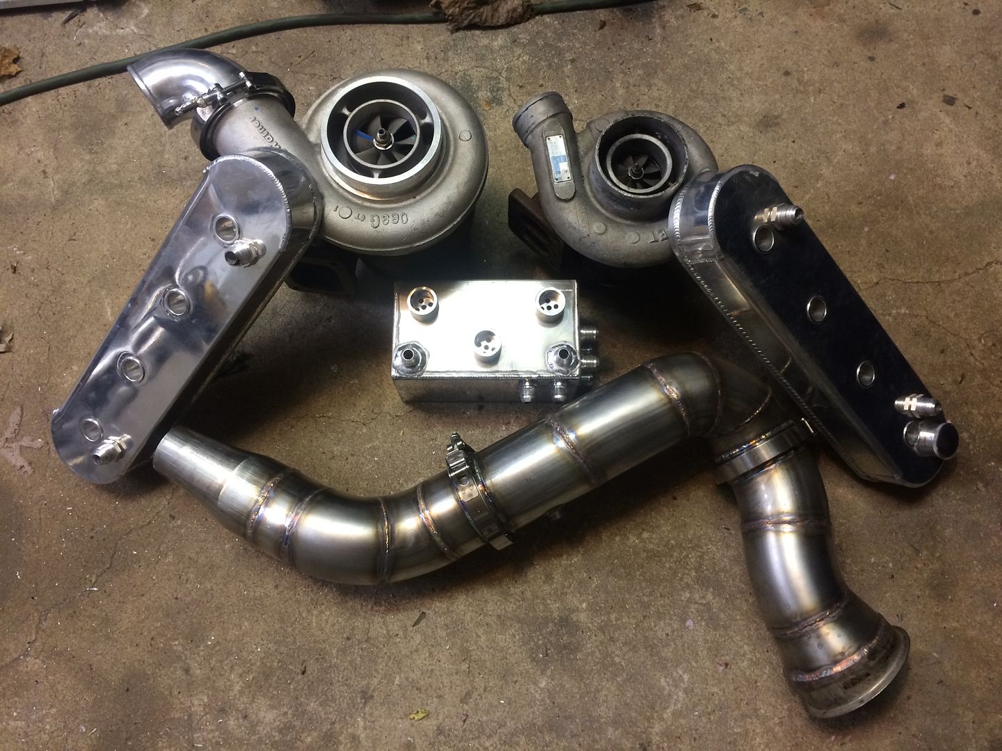

    The last few days got a lot of tig welding done.
    My friend and I are building a Volvo T5 w/ hy35 swapped e36.
    We made a new oil pick up tube from scratch and shortened a t6 oil pan and redid the front section to clear his rack/subframe. Came out awesome. Then I got all the welding done on my down pipe, it's such a good feeling to make something from nothing and progress with quality as time goes.

    Tacked up the downpipe, just need to weld it up tomorrow and start the oval.

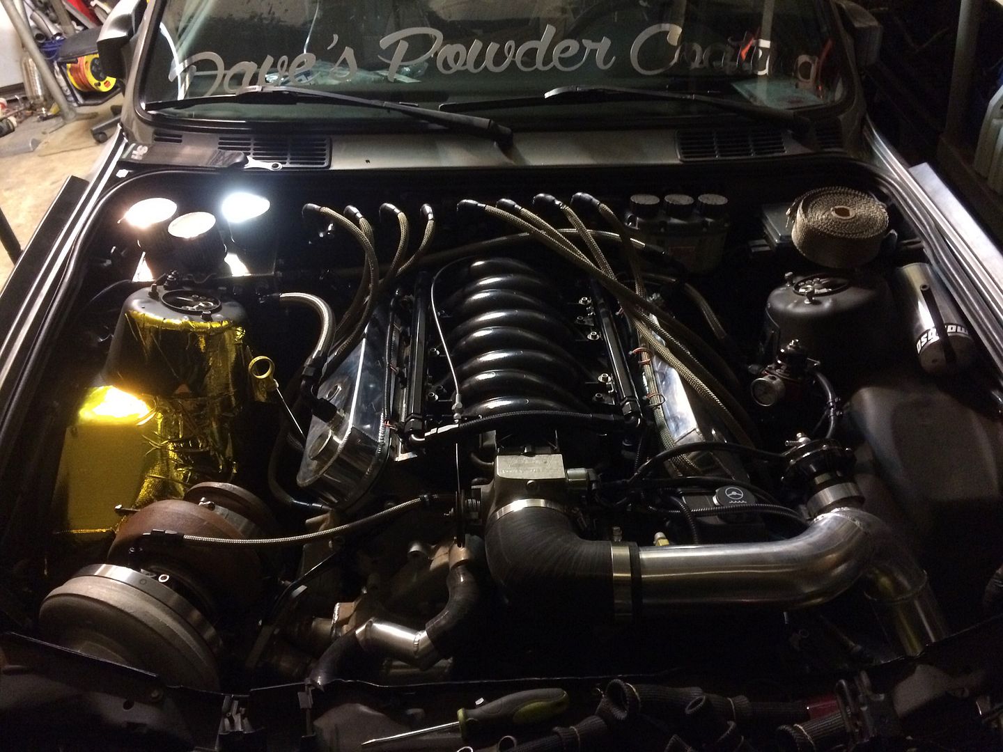

    Finally made an idler pulley for up top that bolts over the water pump.
    Alternator bracket is adjustable and ended up using a ford 5.0 belt.
    Also ordered my driveshaft soooooo this turd is almost ready to melt some tires.
    Also the 2 step works....can't wait to turn it waaaaay up

    Finished up coolant piping today. Diff showed up from reshimming too.
    Now I need to seal up the diff and put that in so I can order a driveshaft.
    This thing if finally getting towards the end.
