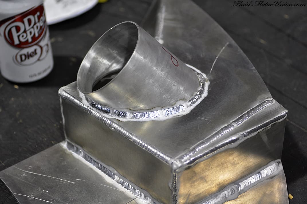

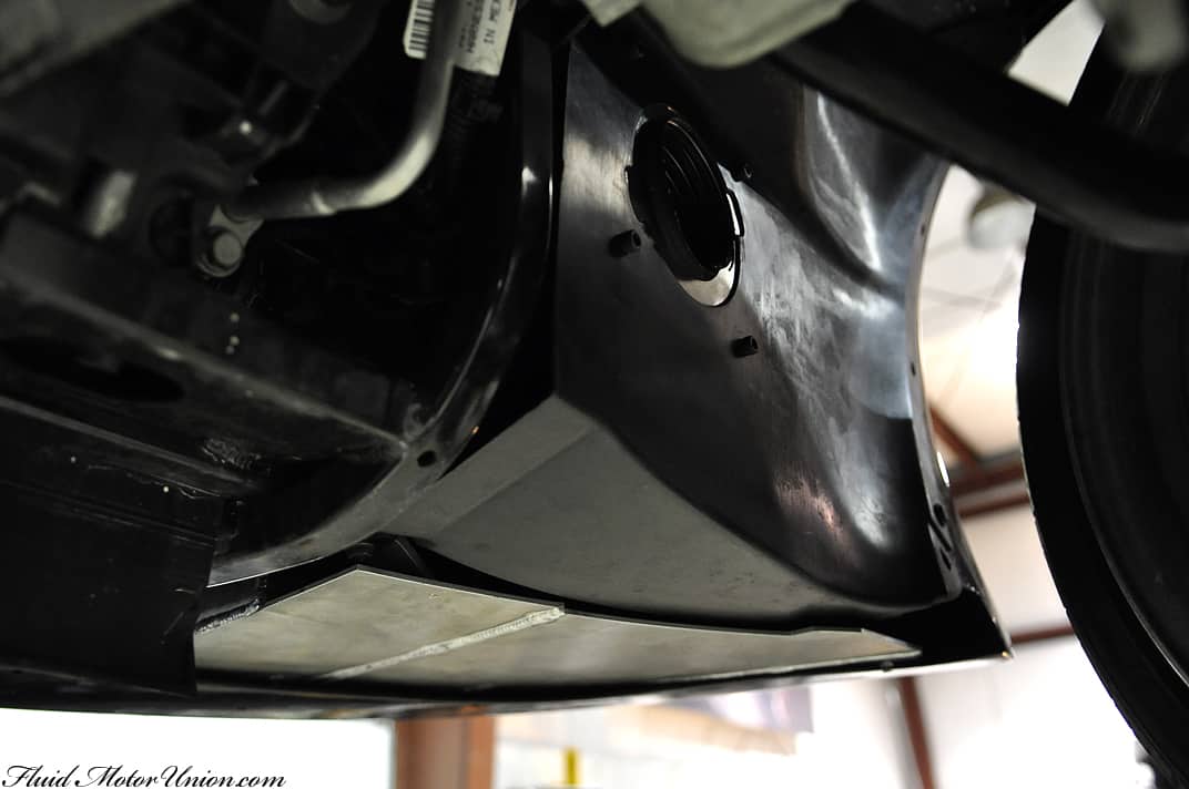

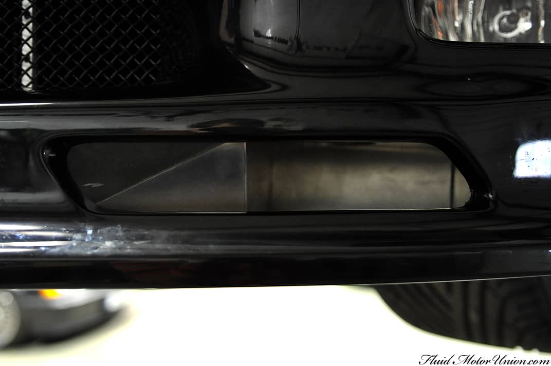

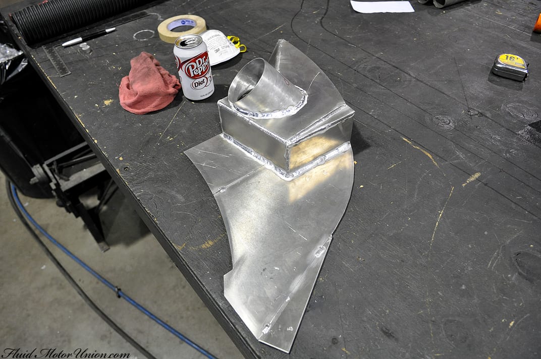

And there they are (well, there one is), in all their (its) glory. The point to these brake ducts is not merely aesthetic; using our design, the cold air from down low is brought through the bumper, through our ducting, and into the wheel well, where that air will help keep the brakes cool. Simply put, the less heat the brakes are constantly experiencing, the better the overall braking experience. Pedal feel will become less vulnerable to change, and the ‘Vette will be able to stop faster more often with greater consistency, an absolute need on the track. Here’s what they look like, installed behind the front bumper. We’re choosing to leave them unfinished, as it gives the vehicle a grittier, less-refined look. Which is how a Corvette should feel, since it certainly drives like an unhinged lunatic.
